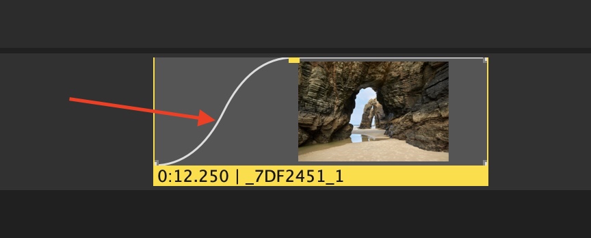

Good evening Christoph,
regarding my request I'm talking about the main curve which in Wings 7 - Media Pool were called "Ramps" and which I can create, save and set as default for all the images I am going to insert in that project and in other new projects.
I am attaching a sample screen capture.
Daniele
Daniele

Good morning Daniele,
concerning the default curve: It is already on my todo list, to implement the selection of a default curve in the pool. But since the fade-in/out ramps consist only of one single point, which is adjusted in a blink, this is not really a requested/needed feature anymore.
Concerning the bezier handles: There are no plans, to implement that again in Wings X since it adds unnecessary complexity. We had this discussion already a very long time ago in the forum and nobody was able to come up with a standard characteristic for crossfades which would require more than the single flexible point of Wings X. And fpr the rare special cases, you can of course use as many points as you like. Therefore I am pretty convinced that this solution is optimal.
And the proportional changes to an objects duration are also on my todo list.
